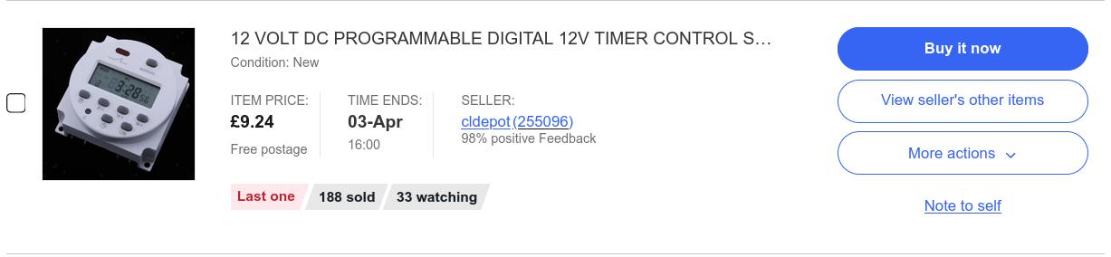

Seen this 12v one on ebay, looks the same.
Seen this 12v one on ebay, looks the same.View attachment 129404View attachment 129405
Used the one I've got for24v electric teas made and one in the van for front lights . They don't get hot have 16 programs for start stop and constant auto and off. Run upto 16 amp 3 years in. Very nice
If your using it alot they do one with a larger trigger button.
But All my leds run off 5v 3 amp usbs now as they got hot and kept falling down but stayed up over a good time. I need help now as to what glue will hold them ( LEDs) up for second time as hot glue did not work Lol .
This is the teasmaed with the bigger on / off switch simple 1 loop and in / out and power on off
And this is 12v for lights in van
