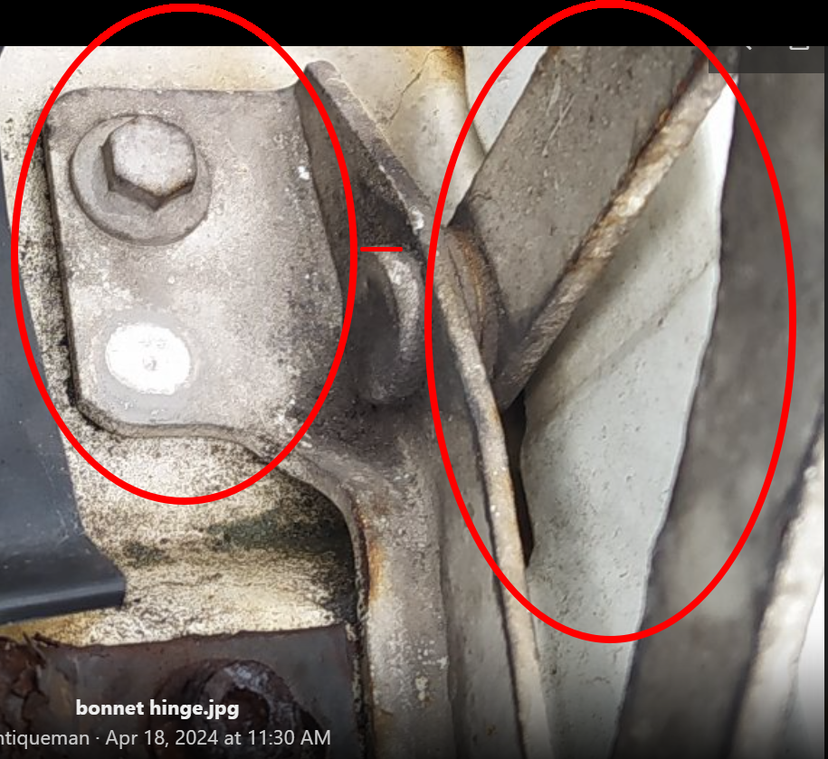

This is a picture of nearside as the offside has disintegrated the wing is bolted to the bracket at the top and the bonnet hinge below, I would imagine the offside is the same in reverse.

If you mean the circled parts that is one unit with the hinge, not a mounting bracket and then a hinge so should be easy to find, the 2000 model was just a face lift so one from that might fit

No its the bracket underneath that I want where the wing is bolted the hinge is fine it is just bolted to nothing unfortunately
I see, I'm assuming it's the scuttle panel which is welded to the screen pillars, the screen support and the back of the dash I think, so it'd be a repair panel or something, maybe just get away with a patch.
Impossible to be sure from here, can you do a short video showing a bit more?

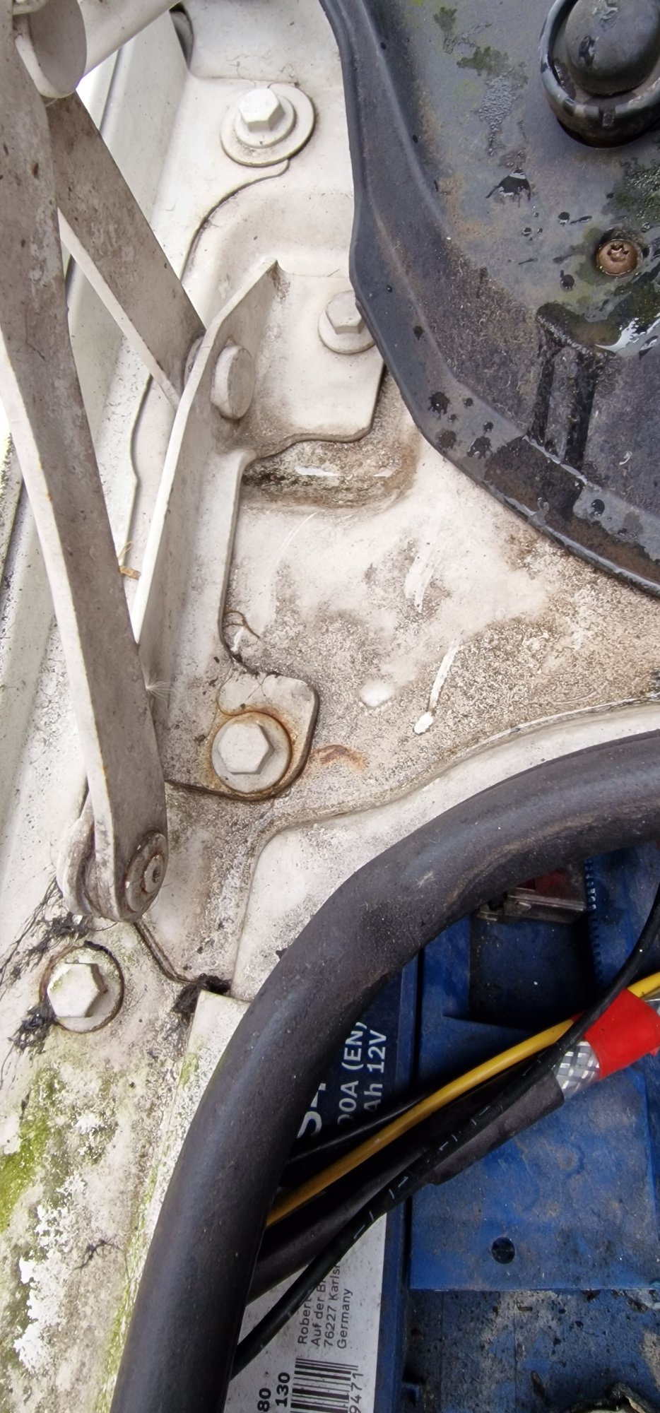

Part of the Bulkhead structure I'm afraid ....

Picture of our drivers side and underside of it where the hinge bolts pass through the captive nuts .

Thanks for that my friend with glue gun is not free for two weeks then I will strip it all down, it is a mess I might have to fabricate some bits unless I can cut some out of a breaker.
It could be a lot worse by the sound of it, while the bonnet is off you may as well do a bit of preventative work on the other side as it maybe the same under the surface.
A tip for bonnet removal is to drill a 3mm or 1/8" hole through the hinge mountings then there is no messing about to re-align it.
